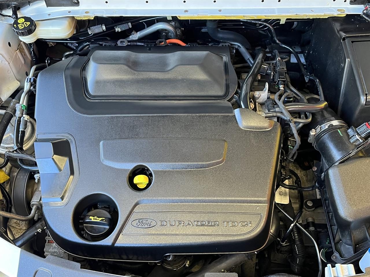

I actually looked at a (2012) MC Flywheel just yesterday - would have taken a photo if I'd known. Anyway, if your engine looks like this https://www.trademe.co.nz/a/motors/c...ing/4615517072 (if the link works), then it's 2011-2014, the TED4 engine, which I promise, only has a lightweight, 'standard' (light single mass) flywheel. The damper springs are inside the clutch drum on these models, and there's a dog drive to the transmission.
So, if it's really knocking like the one in the Alan Howatt video (an MD with a DMF and manual transmission), then I don't know what the heck! I'd be nervous driving it, and don't know what the problem is. If it's not so loud, like in the first video, I'd suspect it's very loose damper springs - all the plastic bits are destroyed and gone - but I don't have that experience. I imagine the starts will be prone to shudder, and the changes will be jerky.
Anyway, if that's the case, the Sump (Primary) Filter will very likely be getting very clogged and could rupture at any minute, due to metal filings from the springs wearing against the clutch "drum" tunnels. So that might be the end of the debate.
